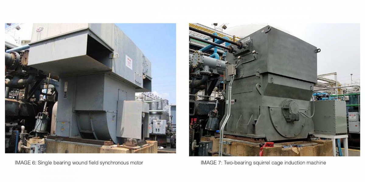

Even when the process shown here is followed directly, there are always unique cases that bring up not-so-easily answered questions. What if a user wants to change from a single bearing wound field synchronous to a two-bearing squirrel cage induction machine to increase protection, simplify operation and simplify alignment? See examples in Image 6 and 7.
What if the motor is installed and the end user then has concerns about previously unspecified or uncovered items including unexpected motor noise or housing skin temperatures? What if a replacement motor interacts with the motor control center (MCC) in ways that differ from the previous machines but are not otherwise a maintenance concern?
The best advice here is the same as in many other areas of life: stay calm, work methodically and always collaborate with trusted vendors. Additionally, with motor sourcing, it is often the case that the simplest solution is the smartest solution and there is much to be gained in leaning on industry best practices and common sense.
IMAGE 6: Single bearing wound field  synchronous motor and IMAGE 7: Two-bearing squirrel cage induction machine
