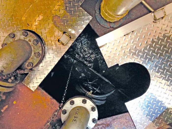

Once the PVHMC decision makers were on board with the selection, two of the submersible shredder pumps were installed in a duplex arrangement inside the 16-foot-deep sewage ejection pit. During installation, under the direction of Cortech Service Manager Mark Fox, Cortech's on-site technicians installed a lifting chain, electrical wiring to a 15-amp breaker for the duplex control panel and the seal moisture-detection relay, and new stainless steel check valves.
