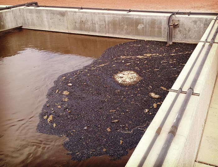

If all equipment is well-designed and the processes are running normally, the activated sludge is similar to water but with a brown mass of bacteria. The dry substance content, also called the TS value, may be approximately 2 to 3, while the bacteria may be visible as fine brown substances.
In some systems, however, pieces of fibers, hygiene products and other synthetics may be visible in the biological tanks (see Image 1). These materials cannot be recycled at this stage by biological treatment. The screen—one of the first steps in the treatment plant—should remove these non-biological materials. All the remaining non-biological ingredients are obstructions in the treatment process. If pumps continue to chop the braided wipes and other loads, treatment plants may increase the disposal and treatment challenges.
While breaking non-biological materials into smaller parts can pose challenges for the biological treatment process, these rags and fibers in sewage are difficult for any facility to handle, especially in the modern world when people are using more wipes and other synthetics that enter wastewater.
