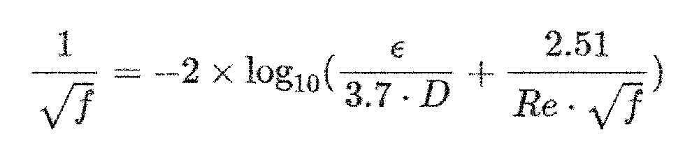

Major losses can be calculated using the Darcy-Weisbach friction factor (f), which is a function of the pipe absolute roughness,   inside diameter and the Reynolds number (Re). The Colebrook equation (Equation 1) defines this relationship implicitly, which means that f must be calculated by plugging in values of f and comparing the left- and right-hand sides of the equation. It is important to note that Equation 1 is typically used for turbulent flow (Re>4,000) and using it in the transition zone between laminar and turbulent flow regimes will result in greater error. Refer to the Hydraulic Institute (HI) Data Tool and the Moody diagram for laminar and transition flow regimes.
Equation 1
Equation 1: Where: f = Darcy-Weisbach friction factor (unitless) D = Pipe inner diameter in feet [ft] (meters [m]) Re = Reynolds number of the flow (unitless) ε = Absolute roughness of the pipe in ft (m)
This method can be solved using a programming language by iterating the value of f and using logic statements to compare each side of the equation. It can also be done in Excel with one column for the f value and another two columns for each side of the implicit Equation 1. The f value would be the one that results in the right-hand side and left-hand side being approximately equal.

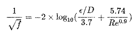

  1. By using an explicit form of the Colebrook equation (Equation 2) with variables as defined in Equation 1
  2. By using a Moody diagram
The explicit form of the Colebrook equation shown in Equation 2 is slightly less accurate than the implicit Equation 1 but can be solved by plugging in the absolute roughness, the Re and the pipe inside diameter of the pipe, and it can be solved without iteration. The Moody diagram can be found on the HI Data Tool website and is a graphical representation of f as a function of Reynolds number and relative roughness.
Equation 2
Equation 2

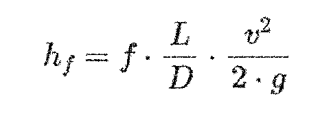

After determining f, the major losses  can be calculated by Equation 3, which is a function of the f, pipe length, pipe inside diameter and velocity. Note that if there were multiple pipes of differing inside diameters and flow velocities, they would all need to be considered separately and summed together to get the total major losses.
Equation 3
Equation 3: Where: hf = Head loss in ft (m) f = Darcy-Weisbach friction factor (unitless) L = Length of the pipe in ft (m) D = Pipe inner diameter in ft (m) v = Average velocity of the flow in feet/second (ft/s) (meters/second [m/s]) g = Acceleration due to gravity 32.2 feet/second squared (ft/s2)(9.81 meters/second squared [m/s2])
