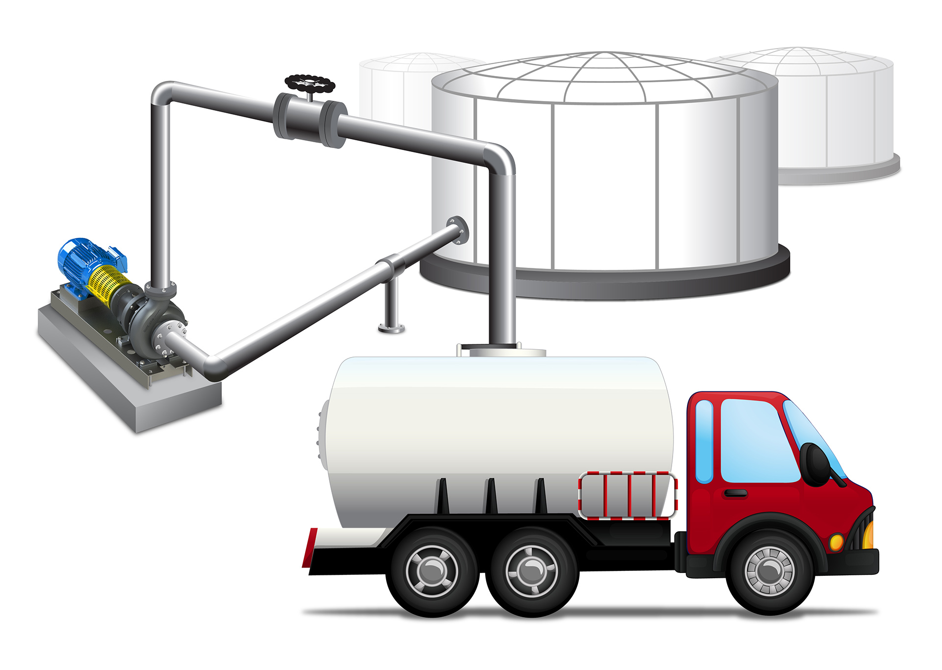

IMAGE 2: Truck loading process
In Image 2, a typical truck loading process using either a centrifugal or positive displacement pump has a manual shutoff installed at the point of tanker loading. When the loading operation closes this valve without warning, considerable pressure builds in the line leading back to the pump, creating strain on the pump and risk for failure.

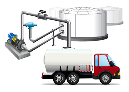

Installation of guided piston relief valve.
IMAGE 3: Installation of guided piston relief valve.
The solution is to add an external pressure relief valve to protect the pump and systems. The self-modulating guided piston valve is ideal for this type of installation as it requires no additional controls.
A new recycle line with a guided piston pressure relief valve is installed between the pump and the loading line. When the tanker truck is full and the loading valve is closed, the pressure back to the pump begins to build. The valve then activates automatically, diverting flow back to the tank and relieving pressure on the line to the pump.
When the next truck lines up and the valve is reopened, and the pressure on the line returns to normal, the pressure relief valve returns to the closed position automatically.
As this is a guided piston relief valve, the orientation of the valve does not impact the valve operation or set pressure. It can be mounted upright, sideways or even upside down—however space permits. This characteristic of the guided piston valve provides design flexibility in retrofitting problem processes.
