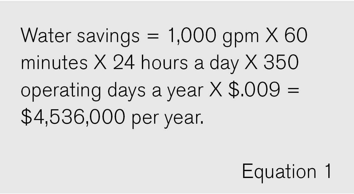

Water & Effluent Savings
Assuming a cost of water at 3 cents per gallon and effluent treatment costs of 6 cents per gallon for a total of 9 cents per gallon at 1,000 gpm (less than the difference between 8% and 18% consistency):
Equation 1

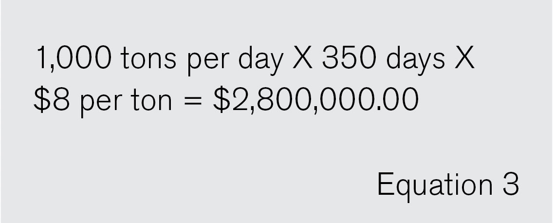

Chemical Savings
Many mills today are running far beyond their initial design parameters. As a result, optimum residence times in the bleaching and extraction towers cannot be maintained. Most mills compensate by increasing stock temperature with steam or by increased chemical dosage.
Higher consistencies improve the bleaching and extraction processes in several ways. For example, operating at 18% consistency instead of 8% increases residence time, which can lead to higher production and/or improved brightness. In addition, there will be an increase in delignification in oxygen and extraction stages. The estimated minimum savings are $8 per ton of chemical savings per bleach plant.
Equation 3
