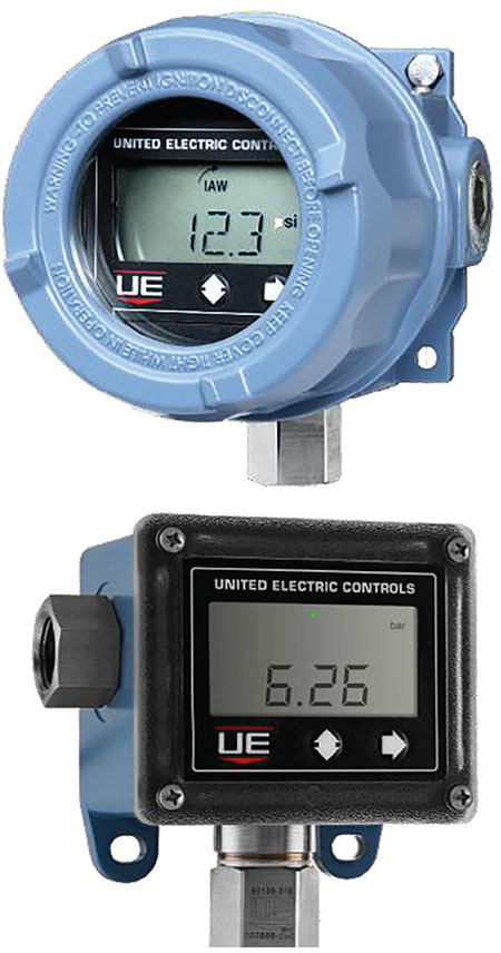

There are instruments in the market today that allow for on-site calibration and verification via the programming interface of the display. This means the maintenance team no longer needs to uninstall the device and bring it back to the instrument shop to calibrate and reinstall the device. Such a solution solves an industry-wide problem and saves up to 50% maintenance time for the operator.

Some instrumentation even has advanced features such as “plugged port,” which can help the pump operator detect if the process port is clogged with media. The following is a case study where the plugged port feature on a pressure instrument installed on a safety shutdown valve helped a major oil and gas producer increase production uptime in a remote oil field.

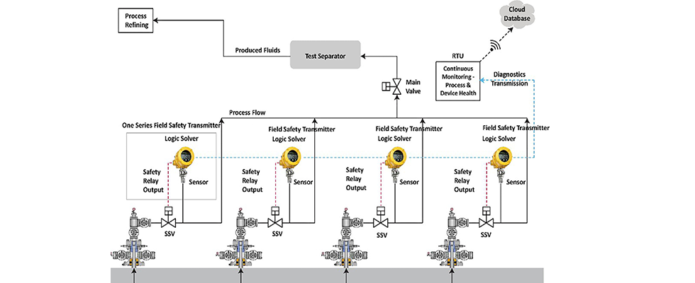

Case Study
Challenge
Four wellheads feed medium American Petroleum Institute (API) crude oil to a separator. During extraction, paraffins could coagulate, especially during colder months. This would cause blockages in the individual wellhead’s hydraulic pressure measurement and safety shutdown system, leading to inaccurate pressure measurements and nonclosure of the individual wellhead’s safety shutdown valve (SSV). If this abnormal condition were detected at the test separator, the main valve accepting flow from the four wellheads supplying it would fail-safe and shut down the entire process, even if other wellheads were operating as designed. Consequently, this would result in process downtime and even potential risk for equipment damage. Labor-intensive inspection of the wellheads to determine the problematic one would be required.
Solution
Pressure instrumentation with the plugged port feature enabled was installed on each wellhead. The feature allowed operators to set time and percent of change values for the process, which would indicate a deviation from normal operating conditions. If pressure flow were restricted due to blockage, the instrument would initiate a direct, fail-safe shutdown of that wellhead, while the others continued to function.
Operators were remotely alerted to the event when the safety relay failed to open, and the 4-20 milliamps (mA) output dropped to 3.6 mA, indicating a fault (per User Association of Automation Technology in Process Industries [NAMUR] standards). Locally, the phrase “plugged port” scrolled across the digital display. By utilizing a standalone system per wellhead, the problematic one was easily identified so maintenance turnaround time and downtime were greatly improved. Blocked flow lines were confined to the problematic wellhead rather than the entire process. Additionally, reduced system design complexity was realized without changing the host system.
