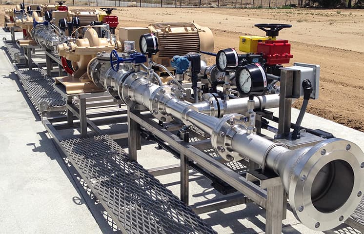

Image 1. Platform-mounted injector systems aerate water in the Hickory Aquifer Groundwater Treatment Facility in San Angelo, Texas, to remove dissolved iron. Shown are two of the four sidestream aeration systems. (Images courtesy of Mazzei)

The city’s Hickory Aquifer Groundwater Treatment Facility maintained flow rates ranging from 2 to 8 million gallons per day (mgd) and an operating pressure of 80 to 100 pounds per square inch (psi). To conduct aeration and mixing with maximum efficiency, the San Angelo team installed a series of four parallel sidestream treatment systems featuring Venturi injectors and degas separator units, as well as a 60-horsepower (hp) pump for each system. The array of four treatment systems allowed the staff to adapt to changing demands within the facility.

Mounting pumps, injectors and degas separators
Image 4. Mounting pumps, injectors and degas separators on steel platforms instead of concrete floors eased access to pumps and pipes for system maintenance.

Split-casing pumps were specified to keep impellers accessible, facilitating maintenance on the only moving parts in the system. The Venturi principle creates a vacuum as the flow of liquid or gas expands in the injector’s outlet chamber, so there are no moving parts. Oxygen is drawn from the atmosphere, so the system requires no chemicals.
All aeration components are installed on steel platforms to further facilitate access. Mounting the pumps on steel platforms rather than concrete pads necessitated finite elemental analysis (FEA) to fine-tune platform design and reinforcement to minimize vibration.
