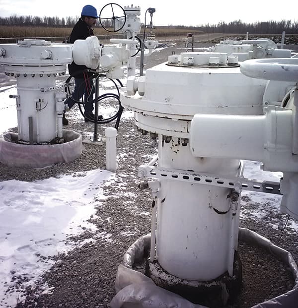

Check valves at the entrance and exit of the pump circuitCheck valves at the entrance and exit of the pump circuit determine if the products need to enter the circuit or continue through the pipeline.
