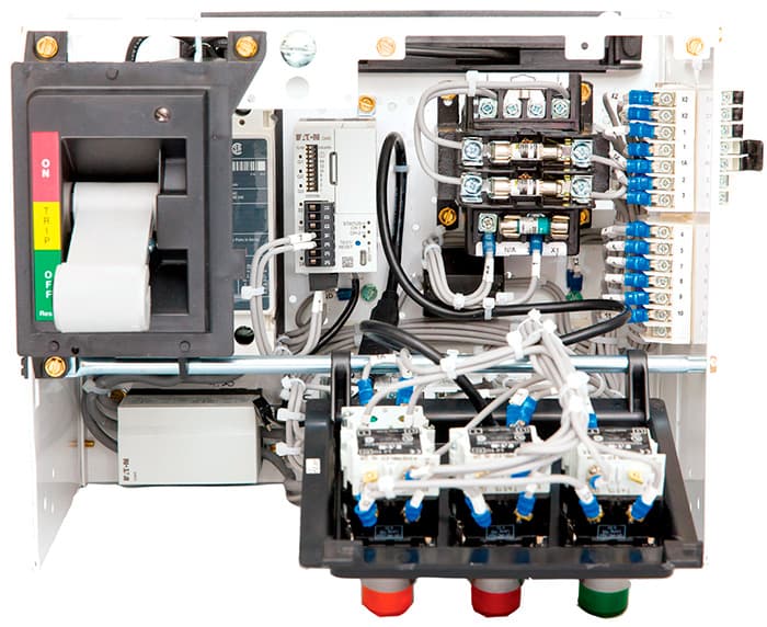

Image 1. A motor management relay can provide monitoring accuracy and protection for the entire power system from the incoming power source feeding the motor all the way to the individual pump or load. (Images courtesy of Eaton)Motor Management Relays
Many new options are available when it comes to protecting pumps from various issues associated with motor overloads. Motor management relays are one example of an emerging technology that enables improved diagnostics and intelligence of pumping systems without requiring a complete overhaul of the distribution and control system. These motor management relays increase energy awareness, improve diagnostic capability and enhance uptime through excellent monitoring and protection. These devices communicate on all standard industrial protocols and provide performance data on entire pumping systems. Unlike legacy overload relays, motor management relays contain features such as real-time clocks, non-volatile memory backup, motor temperature protection, efficiency monitoring, fault queues, trip snapshots and optional algorithms that provide automatic restart after an outage. These relays are also capable of remote configuration and monitoring, which contribute to operator safety. Another example of product evolution in the smart pumping space is in drives technologies. Drives can support communications and save energy costs in the process. The general-purpose drive incorporates an energy-control algorithm, extensive onboard industrial communication protocols and built-in harmonic reduction to help reduce the cost of using a drive for pump control.
