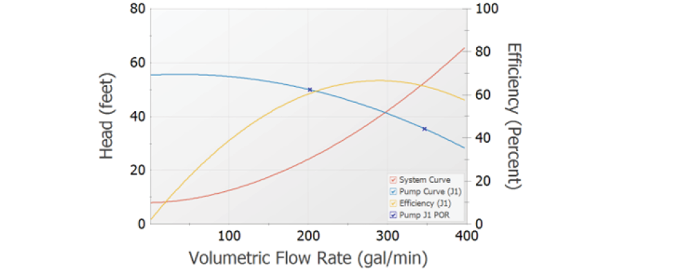

As one half of the tag duo, the pump is what produces the flow and pressure to achieve the demand. The pump system operating point is where the pump curve and system curve intersect. This is because the head required by the system for a particular flow rate (demand) is produced by the pump for that same flow rate. The two are in equilibrium. Image 1 demonstrates a standard pump and system curve graph illustrating this equilibrium. The operating point is the intersection of the two curves around 300 gallons per minute (gpm) and 40 feet of head.
The best efficiency point (BEP) of a pump is key to understanding a pump’s performance. The BEP is where the pump manufacturer designed their pump to operate. This is because it is the point where the pump is most efficient. Think about this idea of inefficiency. The power required from the motor to rotate the pump impeller does not get perfectly transferred into the fluid to propel it, though the goal is for it to transfer as much of it as possible. The additional energy not being transferred into the fluid must go somewhere, typically in the form of heat, sound, vibrations and recirculation. All these inefficiencies are poised to destroy the pump, either through damaging seals, bearings or other wearable components. The best way to mitigate this is to operate near the BEP. American National Standards Institute (ANSI)/Hydraulic Institute (HI) Standard 9.6.3 states that pumps should operate between 70% and 120% of the BEP flow rate to improve energy usage and reliability.

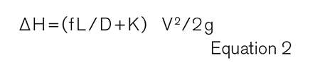

The system is what is resisting the fluid flow. The higher the resistance in the system, the greater the pressure required to push the fluid through the system. What impacts the head required by a flow path in piping and pipelines? Consider the following equation:
Perhaps the pipe length can be shortened? This is unlikely, as an optimal path has likely already been picked or there are space limitations. What about increasing the diameter or lowering the velocity? Usually, these two are done in tandem because if the flow rate is fixed, increasing the diameter will lower the velocity. This indicates that a larger pipe will require less power from the pump. However, there is a diminishing return. All pipes cannot be 72 inches just because it will require the least amount of power for the flow rate. Pipes are expensive, and that is not even considering that the pump would also be expensive and not operating around its BEP. All projects are unique, but one estimate for a pipe’s cost for materials and installation is $250,000 per inch-mile.

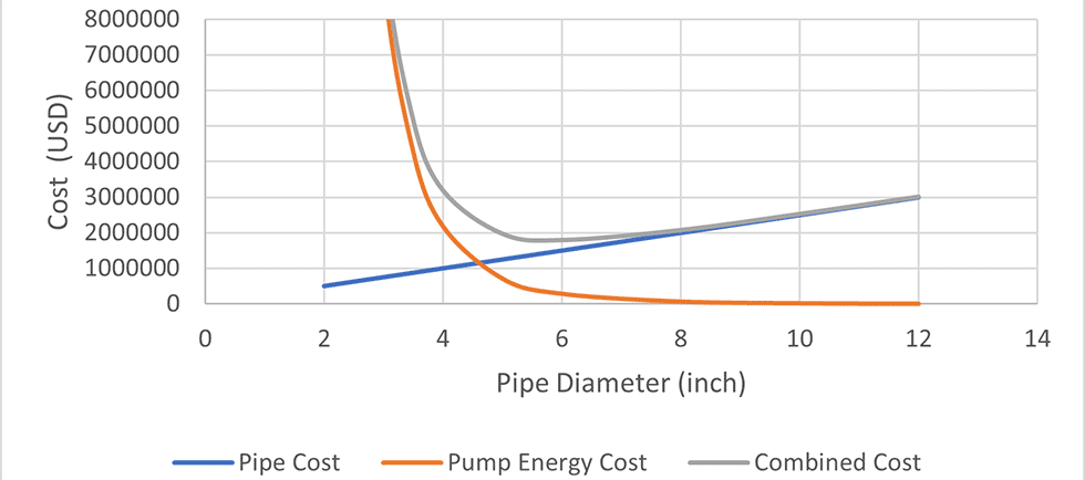

To determine the most economical pipe diameter, the cost of energy to operate the pump and the cost of the piping can be determined for a range of pipe diameters. Note Image 2 as an example. For a set flow rate to meet demand, the smaller the pipe, the cheaper it is to procure. However, the trade-off is the pump would need to push the flow at a higher velocity. The higher the velocity, the more resistance the fluid experiences in the pipe. The higher the resistance, the more power the pump needs to supply. Depending on the expected life of the pump system, a balance between the two costs can be found. Within the graph, the savings of selecting a 6-inch pipe over a 4-inch pipe could be a 50% reduction in power consumption over its estimated 60-year lifespan.

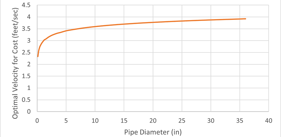

If the flow rate is set, changing the diameter changes the velocity. This can be expanded to show that there is an optimal flow velocity to aim for in piping systems. Taking the previous idea about having an optimal pipe size (and thus optimal flow velocity for a set flow rate), velocity and pipe diameter can be linked together. An optimal velocity for the lowest combined cost of piping and pump energy is often between 3 and 4 feet per second with a pump running at 70% efficiency, with steel piping and operating for 60 years. This confirms a rule of thumb for the water industry, which aims for 3 to 5 feet per second flow velocity.
The graphs in Image 2 and Image 3 are conceptual examples with rough numbers. For a real-world system, analysis should still be done to find these optimal pipe sizes and velocities to meet the demand. However, the overall concepts will remain the same. A larger pipe size, while more expensive upfront, may be more economical over the lifetime of the pump system, and selecting a modest velocity goes a long way for an optimal design.
