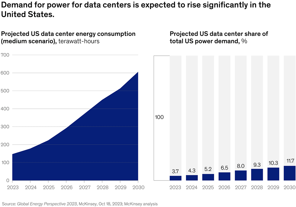

In 2024, the United States Department of Energy set a goal to increase U.S. nuclear power capacity by 200 gigawatts (GW) by the year 2050. This goal was established to ensure that a reliable, clean energy source exists to power anticipated future power needs, which have grown exponentially with the advent of artificial intelligence, electrification, cryptocurrency and other power-intensive data processing requirements.
While new reactor technology—such as small modular reactors (SMR)—is continuing to progress, a more immediate opportunity is present in increasing the output of existing operating facilities. For this reason, many nuclear power plants are in the analysis or implementation stages of extended power uprates (EPU), which increase the generation capacity of the unit. This increase in capacity is accompanied by an increased flow requirement into the reactor, which in turn requires greater flow and total developed head (TDH) through the reactor feed system.
IMAGE 1: Projected rise in power consumption due to data center requirements, per McKinsey (Images courtesy of Hydro, Inc.)

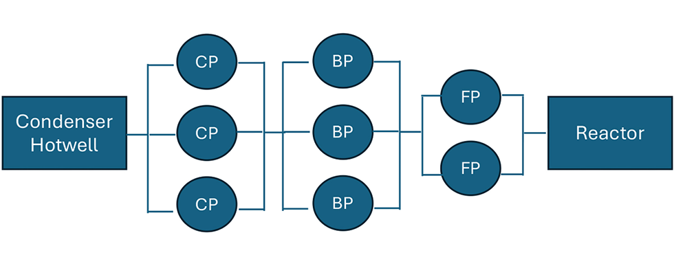

The engineering study began with an overview of how the equipment was operating at the existing system demand. This overview helped the aftermarket service company understand how head was distributed between the applications and what additional head was required to meet the new system flow. The subject nuclear plant’s reactor feed system had three pumps operating in series: a condensate pump, a condensate booster pump and a reactor feed pump.
IMAGE 2: Feedwater system pumps
The existing alignment of the feed system pump train was three condensate pumps operating in parallel, feeding three booster pumps operating in parallel, discharging to two reactor feed pumps operating in parallel. The approved EPU required a 16.3% increase in flow and a 2.77% increase in TDH from the three applications acting in series.
The design of the subject pumps was:
  • Condensate pump: 3-stage vertical can (VS6) pump with below ground suction, fixed speed, electric motor driven
  • Booster pump: Single-stage double suction (BB1) pump with volute casing, fixed speed, electric motor driven
  • Reactor feed pump: Single-stage, double suction impeller with diffuser casing, variable speed, steam turbine driven
The initial investigation uncovered that all pumps were operating back on their curve, away from the BEP. Further investigation uncovered that the TDH of the three applications acting in series based on the OEM design was significantly greater than the actual system resistance. This condition where the pumps had been “oversized” was most likely due to conservatism on the part of both the system designer and the pump OEM, a common occurrence within the industry.
The initial analysis also identified the main constraints on the system, which included horsepower limitations for the motor-driven condensate and condensate booster pump, net positive suction head required (NPSHr) margin for the condensate booster and reactor feed pumps, turbine speed and horsepower limitations for the reactor feed pump and pressure limitations of ancillary equipment, such as demineralizers, installed at various points within the system. These constraints would need to be taken into account when considering any head redistribution between the three applications.

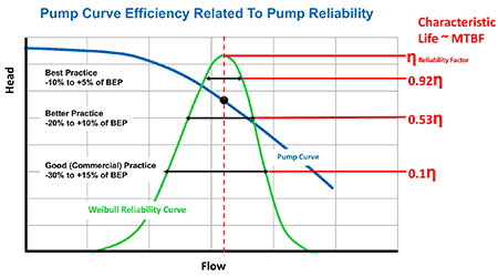

Operational excellence of pumps is achieved by mitigating hydraulic instability at both the impeller inlet and exit. As stated previously, this is accomplished by operating each pump within -10%/+5% of its BEP. A study conducted by Waloddi Weibull demonstrates the impact on pump reliability when not operating at BEP. Another important consideration is the necessity of providing acceptable net positive suction head available (NPSHa) to NPSHr margin.
IMAGE 3: Weibull reliability curve
All these considerations were employed to optimize the hydraulic parameters of each application.
Test data was available for the condensate and booster pumps from the aftermarket service company’s certified pump performance test lab. Using this test data and the OEM factory test of the reactor feed pump, the following can be concluded regarding the above-stated reliability parameters:
  • The condensate pump meets all conditions for EPU and EPU +5%.
  • The booster pump meets the net positive suction head (NPSH) margin requirement for EPU and EPU +5% as well as the BEP requirement for EPU.
  • The reactor feed pump meets the NPSH margin requirement for EPU and EPU +5%.
The study initially concluded it was probable that all reliability parameters could be met for all applications for EPU and EPU +5% if the booster and reactor feed pump impellers were redesigned to have BEP at the EPU flow condition. The redesigned impellers would fit into the existing casings, requiring no   modifications to the existing foundations and structures. It was recommended computational fluid dynamics be employed to validate the interaction between the new impeller and existing casing would not cause flow separation and subsequent loss of performance.

While evaluating the recommendations that were proposed by the aftermarket service provider, the site uncovered an additional set of conditions that changed the course of the analysis. Because the reactor feed pump arrangement used two 50% pumps in parallel, the loss of a single feed pump would have created a condition where the other pump had to deliver 68% of EPU flow to avoid shutting down the unit.
This new scenario made the previously supplied recommendations untenable. In this new condition, the single operating feed pump would increase speed significantly, and analysis showed that both the turbine overspeed limit and design turbine horsepower rating would be exceeded. American Petroleum Institute (API) 612 limits steam turbine overspeed limits to approximately 27% above the rated speed; the required speed in this scenario was approximately 39% of the design speed. The site reached out to the steam turbine manufacturer and confirmed that this speed would be unacceptable.
Additional head would need to be added to either the condensate or booster pump to reduce the head generation required by the single feed pump, placing the turbine back within its design parameters. Given the limitations of the current electrical supply to the condensate pump, the site decided to place the additional head in the booster pump.
Having done their due diligence to understand how the reactor feed system pumps would react under different operating conditions, the nuclear plant was able to choose a path forward that reduced risk and best suited their reliability goals and project budget. In lieu of supplying redesigned impellers within the existing casing, as had originally been planned, they opted to work with the aftermarket service company to custom-design new booster pumps and feed pumps to operate at their BEP and to deliver the required pressures.
