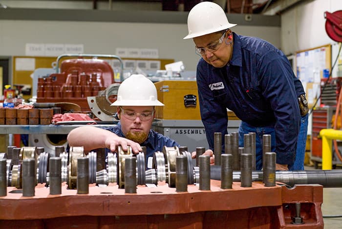

In almost every application associated with the thermal cycle, the pumps are process critical and will have to be swapped out for service. In a scheduled overhaul or nonemergency situation with proper planning, replacement wear parts should be in stock at the user’s site, pre-purchased for the planned maintenance. If the replacement wear parts are readily available or reproducible by the chosen repair partner, this allows the work to be completed within the planned maintenance time frame. This is important when a spare pump is not available and ready for exchange.
Repairs made as part of a standard, scheduled overhaul will usually meet user requirements for a straightforward return to service. What the user expects is a refurbishment that achieves the objective of reclaiming the original performance, replacing wear parts and resetting the clock to the next scheduled overhaul.

Proper planning is important in cases when the pump is of an age where a simple repair can become more difficult due to changes in design or poorly documented past repairs. Planning may require the assistance of a known or trusted repair partner. In most cases, employing one with pump design and manufacturing capabilities will be beneficial.
Very often, it will be possible to engineer new components that incorporate modern design and manufacturing technology to create parts that are more effective and durable. Then the simple repair begins to look more like a retrofit, where additional benefits can be included with the replacement of a series of parts. Improved performance or longevity can be achieved by addressing a design issue or simply applying new materials and designs developed during the normal product life cycle.
Many pumping assets have been in service for a considerable number of years. During that time, the technology used in designing and manufacturing components such as impellers has progressed a great deal. This means that plant owners can benefit from increased efficiency or make changes to duty cycles without having to replace complete pumps.
Modern 3D design software and computational fluid dynamics (CFD) are now integral to creating an optimum hydraulic design. Companies that frequently repair pumps from other (sometimes obsolete) manufacturers will use these tools in tandem with reverse engineering techniques to manufacture new components when required.
While parts can be reverse engineered using precision instruments, a professional, independent maintenance provider will also constantly review original designs looking for ways to make improvements, using their experience and knowledge to enhance the design.
Selecting the most appropriate replacement components for a power generation pump should not be a case of accepting the specification of the legacy item. Moving to modern materials for wear components is the simplest first step for gaining time between required repairs. Adopting new impeller designs, for example, is the most common way of improving performance. The application of one or more of these retrofit options can clearly improve performance and extend the life cycle of this type of equipment.
Modern surface coating technology can also be applied to legacy equipment as part of a refurbishment program, such as extending the service life of a pump by rebuilding worn surfaces ready for re-machining or applying tougher, more wear-resistant surface finishes. Implementing a new coating as part of a refurbishment project can significantly improve the performance and reliability of existing equipment. However, it is critical to select the most appropriate type of coating and application method to guarantee positive results, which is where experience counts. Hence, choosing the right repair partner with experience in all types of coatings and their application in thermal system pumps will be beneficial.
