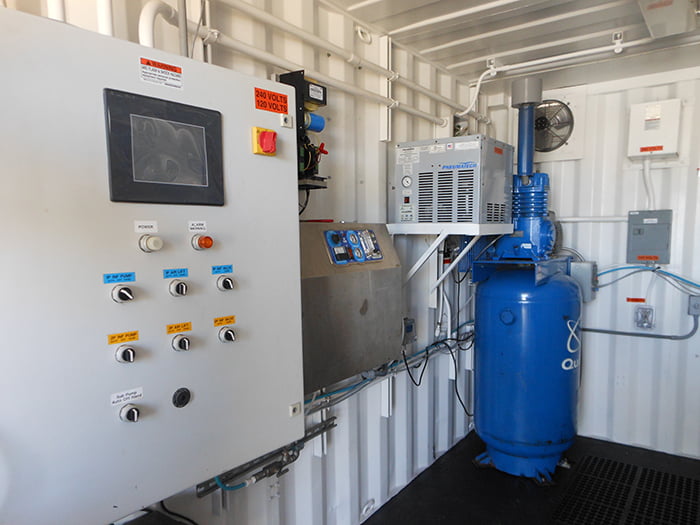

The portable water treatment process trailer was built on a 40-foot flatbed trailer and includes a 20-foot metal shipping container housing the instrumentation and process controls. The container also includes the pumps, valves, ozone generator, air compressor and air dryer used in the process. Sample ports, testing equipment and a control enclosure are also housed in the container. This complete water-treatment process training and research platform includes chemical dosing, main fluid flow, and air and ozone fluid flow systems. The external process control system includes a pair of interlaced lime green plug-flow reactors that perform the treatment, and a pair of blue catalytic filter towers (see Image 1). Each 45-foot plug-flow reactor is followed by a catalytic filter tower—a self-cleaning moving bed reactive sand filter. Small doses of functionalized biochar and ozone are metered into the first reactor, with sand in the first filter made highly reactive to remove trace contaminants. Precise amounts of ozone and metal salts are pumped into the second reactor effluent for high efficiency water polishing. At the output, the byproducts, phosphorus and nitrogen bound to biochar, are recovered for use as fertilizer. The effluent then moves through the second sand filter where the water is polished again. The output of this filter is clear, clean water..jpg)

Not only can the process be scaled, the control system can as well (see Image 2). The control enclosure, housing the programmable logic controller (PLC) and human machine interface (HMI) can handle a much larger process. Increasing the size and duplicating some of the power distribution components, motor and drives could enable pumping and treating millions of gallons of effluent per day. The process is automated with the PLC for motor control, opening and closing valves, operating pumps, and metering biochar and ozone. The PLC also monitors flow and level for process signal control and sampling operations. The process treatment sample sensors included pH, redox, dissolved ozone, head-loss, turbidity and total organic carbon. The process control hardware also provides supervisory control and data acquisition for the process trailer, and includes wireless streaming capability. The controller technology offers a modular, rack-based system with extensive discrete, analog and specialty I/O module options. The high-performance CPU has the memory, I/O capacity, communication ports and scan times needed for the current process, and for a larger scaled-up process.Data Logging
Data logging is a vital part of this process and the related research activities. Significant amounts of data are logged using the controller and the HMI. The controller provides up to 32 GB of data storage using a standard microSD card. Users access the controller’s built-in web server using any browser to view, download or delete data log files.
