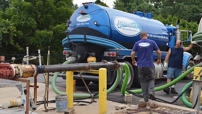

septic dump trucksImage 1. About 30 septic dump trucks bring waste into the VFSA pumping station every day. (Images courtesy of KSB)

“We bring in 20 to 30 septic dump trucks a day from residential septic tanks and industrial facilities. We are very pleased with the way the new pumps handle the difficult septic fluids,” Knauer said. “They pump a variety of different types of material, including rocks and rags. We change the oil about once a year and the pumps have been working great; and the high alloy hardened impellers show virtually no wear after more than 10 years of continuous service.”

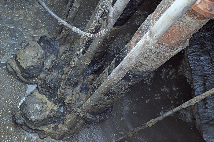

sludge on pumpImage 4. Excessive sludge, rocks and rags are no problem for the upgraded pumping system at the VFSA, thanks to the clog-free, maintenance-free submersible pumps with vortex impellers.
The fluid also generally has fabric and other undesirable materials that are prone to plug pumps. In this instance, based on operating feedback from the plant operations personnel, and in conjunction with the consulting engineer, a supplier recommended a special hardened alloy material for the impeller and pump volute. The net result of an application-specific (wastewater) pump selection is that the end user experiences uncommon reliability.
