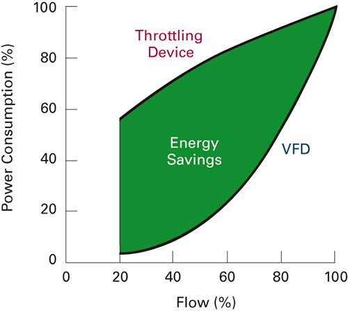

VFDs Versus Throttling Devices
A mechanical throttling device is often used to limit flow. This is an effective control method. However, it wastes both mechanical and electrical energy. Energy use with a throttling device is shown in Figure 5. The lower curve shows energy use with a VFD. Since VFDs adjust the frequency of an AC motor, flow and energy consumption are reduced. The green shaded area shows the energy saved.
| Figure 5. The amount of energy saved by using a variable frequency drive versus a valve to control flow |

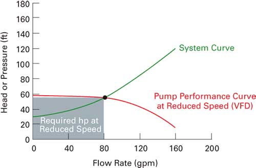

The addition of VFDs
VFDs electronically control power supplied to the motor, closely matching power requirements to produce a specified flow. This is similar to using a new pump with a smaller impeller.
To see the energy savings with VFD technology, Figure 7 combines Figure 4 and Figure 6. The blue shaded area demonstrates the resulting energy savings realized by using a VFD instead of a throttling device.
| Figure 4. System characteristics using a mechanical throttling device. The energy consumed is represented by the blue shaded area. |
| Figure 6. The pump curve and the energy used with VFD control; note that the pressure is also reduced, helping reduce the mechanical stresses that are created with throttling devices. |
