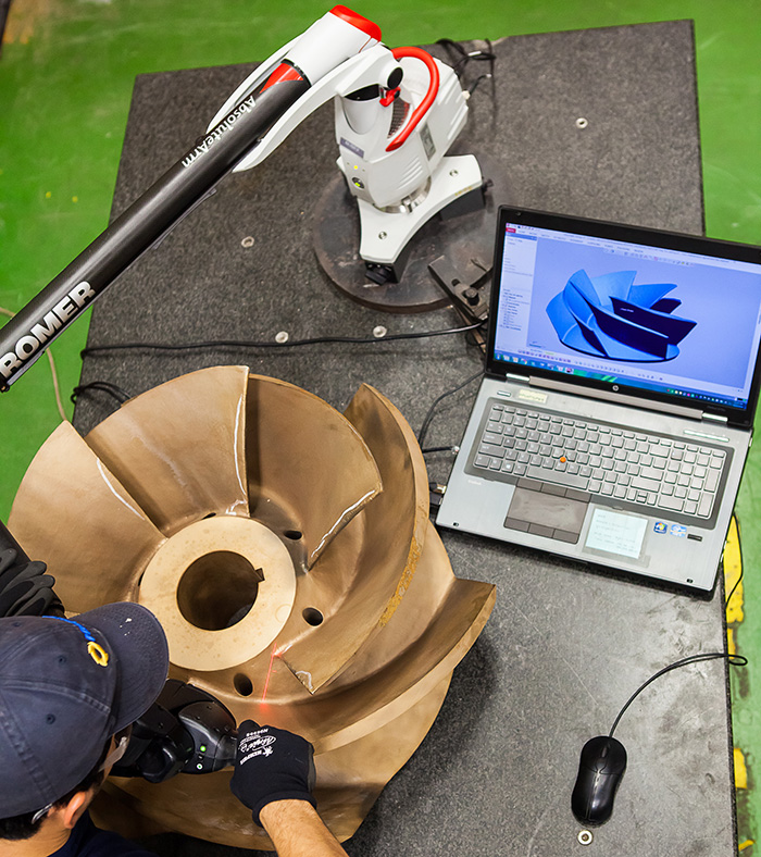

While the pumps were being rerated at one of the repair company’s Texas service locations, the firm’s engineers began an extensive acoustic resonance evaluation and analysis to determine how the existing impellers reacted to the long crossovers. Once this was identified, a new design was created to change and improve the configuration of the impellers, the vane counts and the vane angles.
The engineers developed a complete analysis of the volutes, the impellers and the crossovers, as well as a detailed explanation of how the impeller interacted and reacted within the long and the short crossovers. The analysis took two weeks to complete.
The next step was to build a digital model of the impellers using an exclusive milled vane technology. Unlike casting, milled vane technologies eliminate the need and requirement for a pattern.
Using a traditional pattern in a cast pour, a shifting of the vanes can occur and cause inconsistencies within the design.
Milled vane technology uses a solid block material milled on a five-axis computer numeric control (CNC) machine. The homogeneous material does not have the inclusions inherent with a cast pouring. The material has no deviation from the design and is advantageous when custom building the hydraulics for a specific and unique application.
