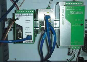

An electrical engineering firm is working with the Lindmore Irrigation District in Lindsay, Calif., to upgrade its SCADA network. As part of this upgrade Phoenix Contact was chosen to provide Wireless Ethernet (TWE) radios, antennas, and power supplies (Figure 1).
Figure 1. A Phoenix Contact radio and power supply mounted in a control cabinet

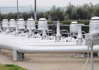

The primary objective of the pumping plant is to maintain reservoir level and flow demand (Figure 2).
Figure 2. Irrigation pumps deliver water to customers in the higher elevations to the east of the canal.
When farmers call with their water requirements, district operators select the number of pumps to operate. Each pump has a selectable setpoint at the reservoir level. Once the reservoir level reaches its setpoint, the pumps stop. Head pressure at the reservoir maintains the line pressure.

The district's original radios used serial data and were limited in terms of bandwidth and data. However, the new wireless system uses Ethernet, which allows engineers to connect via the Internet. The flexibility and Web connectivity of the TWE radios allow the district to connect to nearly any device at any site. For example, operators can monitor VFD status to acquire data such as kVAR and kVA demands to make energy adjustments so they can take advantage of off-peak utility hours.
The new radios offer the ability to configure a single radio as a master, slave or slave/repeater via built-in Web-based management pages. Having this configuration software built into the radio also simplifies installation.
Compatibility with third-party control protocols was another important decision criterion. The ability of the TWE radio to wirelessly transmit the PLC's EtherNet/IP multicast protocol in a quick and reliable manner was a big factor contributing to the success of the upgrade.
